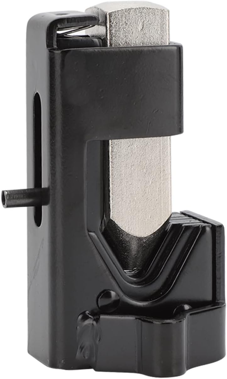

Use proper crimped connectors on the end. If you haven't got a crimper, you don't need to spend a fortune. I got one like this and for occasional use, it's fine
https://www.amazon.co.uk/Youyijia-C...ds=battery+crimper+tool&qid=1717661031&sr=8-2

Glad that one works, Stemar. I don't trust myself to really get that proper "closed up like a block of metal" effect without the hydraulic type or really big levers.
