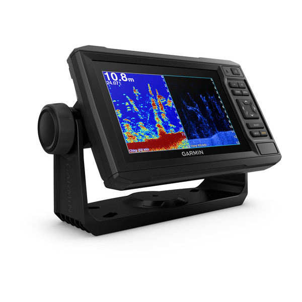

I'd be tempted by a Garmin Echomap Plus 65cv or 75cv, if it would fit.
Other sizes are also available, although I think the smaller one (45cv) is a bit mini.
https://buy.garmin.com/en-GB/GB/p/592847/pn/010-01891-10#
I do like the look of the garmin echomap range, they look a nicer shape than the dragonfly range.

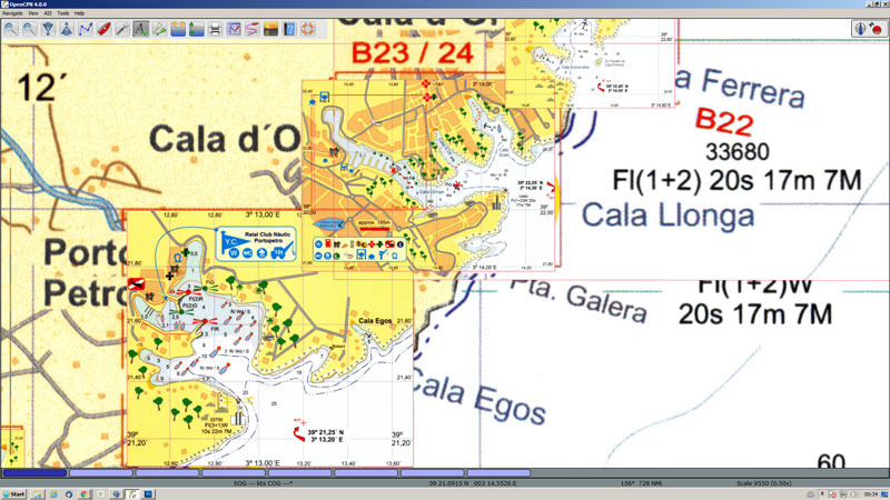

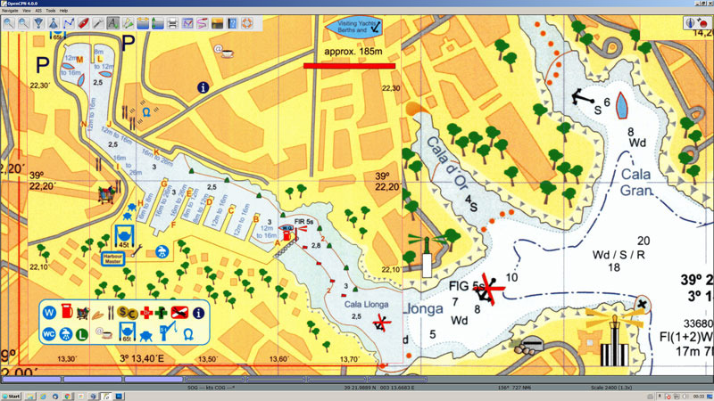

A little bit off topic
But you might be interested in what Iv'e done which works on the Android Tablet.
I've scanned and geo-referenced all the chartlets from the Tula pilots.
There are about 150 charts in each book.
One book for each island (Menorca, Mallorca and Ibiza)
Each of the chartlets that I scanned have been converted into KAP/BSB format so work under OpenCPN
OpenCPN has been available for the Android for a couple of years so it is a relatively easy job to copy these files into the Android and install OpenCPN from the Play Store.
If you have seen the Tula Pilot books, you will know how different they are to the Navionics charts - showing beach bars and supermarkets etc
All as charts inside the OpenCPN marine plotter software.
Let me know if you would like further information.
This is an example - Cala d'Or
