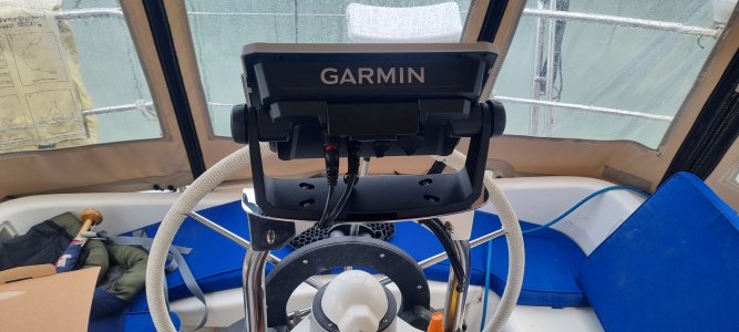

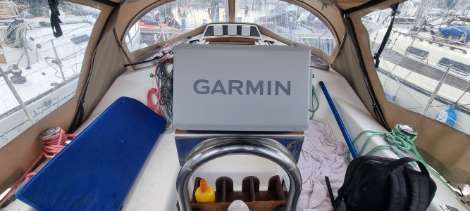

Plotter at the helm are often fitted into pods but i fitted this one for a customer. Local stainless company made the bracket up. The plotter is a 9" Garmin Echomap, it can be removed from the back of it's bracket in seconds.

I have an old Standard Horizon chart plotter fitted in a similar fashion, which I remove when we get back alongside. With the element and other newer chart plotters how waterproof are the cable connections/back of unit. I keep thinking of an upgrade, which I never quite get round to.

They don't seem to give any problems, the one in the pics above has been fitted for almost a year. I've fitted others that have been there for 2 or 3 years,
