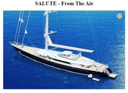

I'm confused by references to the tail/transom door being a source of flooding; in the attached sistership picture the 'door' opens onto to a set of steps and isn't an opening into the vessel's interior. The plans posted above by Bajansailor also seem to depict this arrangement, the toys' dock area being accessed via the side door.
That’s just a fancy bathing platform .It’s not really a door as such .

Thank you for this photo - that explains a lot.
I was trying to figure out from the GA plan how they could have access from the stern door to the aft compartment, but your photo confirms that the only access is via the shell door on the port side.

She was certainly built with the stern steps arrangement as this photo of her prior to being renamed shows. But yes, as you say, it is possible that this could have been changed at a subsequent refit.

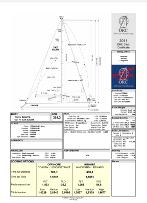

On the AVS, another document is in the public domain - the Bayesian had an ORC certificate and here it is - I didn’t find it, i’ve lifted this from A.N.Other sailing website:
A very different number, but I assume that the swing keel / ballasted centreboard will be locked down for racing as the “centreboard” box shows “NA”.
