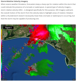

Both waterspouts and microbursts have a signature visible on radar and both can be devastating when they contact the ground ... also very localised in the damage they cause
Microburst Damage
Wind speeds in microbursts can reach up to 100 mph, or even higher, which is equivalent to an EF-1 tornado! Winds this high can cause major damage to homes and other structures and level hundreds of trees. It is very important that you take Severe Thunderstorm Warnings just as seriously as Tornado Warnings!
The image to the right shows just how much damage can be caused by microburst winds. As you can see, this manufactured home was completely destroyed.​
What is a Microburst?
Tornadoes & Waterspouts On Doppler Weather Radar | LakeErieWX Marine Weather Blog
I would imagine if a waterspout or a mircoburst was present then a weather radar facility in Palermo has it recorded and they will probably come out in the course of the investigation - especially as the Airport in Cinisi has a flight approach just north of where the yacht was anchored.

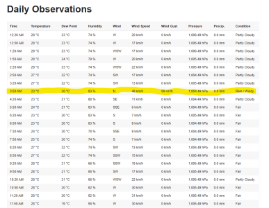

Here is the historic data from Palermo on Monday ... something definitely happened in the early hours of the morning .... the temperature dropped, the wind veered from SW to N and the wind speed surged .... obviously this was on land at the weather station in Cinisi, Palermo, near the Airport, but what was happening at sea round the corner could have been a lot stronger and also localised. The weather up until 3:50am was pretty benign.
Explore the data for Monday here .... Cinisi, Italy Weather History | Weather Underground

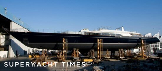

This is the only picture that I have seen which shows the underwater profile.
Think centreboard Sonata!
The ballasted centreboard retracts into and houses in the external keel I’ve seen a figure of ninety tons quoted.

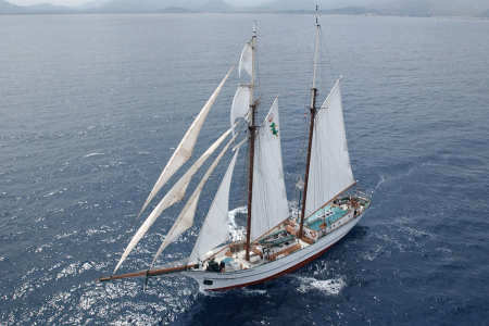

For anyone who may be wondering, here’s a snap of the yacht anchored near to the “Bayesian” and whose Master rescued the survivors from their raft.
She was, I am told, originally an East German harbour tug.
