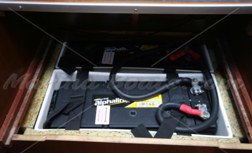

Thanks for the advice Paul. Much appreciated. Yes, been doing a bit of background reading and agree - think I'll stick with lead acid for now and replace the sick leisure battery (keeping them topped up this time with shore power when not on the boat).
I've got space for two truck batteries as in the pic below of the Antares 760 battery box under the stairs (not my boat but my 760 is the same setup) - briefly what would be the benefit of 2 smaller batteries rather than a large single leisure?

The truck batteries are meant for heavy discharge over a short period, they are big and heavy too.
