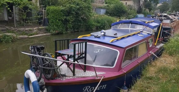

Hi I'm about to put an offer on this dawncraft boat. It's 1978 , how long do they generally last please ?as I read only 50 years on Google.
It's had one crack repaired where a boat crashed into it but that's above the water line . I've not seen it out of the water.
Would it need to be taken out to be maintained every so often?
Hes asking 8k does this seem a fair price considering it's age? Its in good condition otherwise and runs well.
I would be running it on a canal .
Also I wouldn't be living on it and I'm a bit worried about it being stolen or vandalised. Are boats generally safe to leave for a few days? Other boaters say it's a safe area I'm general.
I'm new to the boat scene so I'm asking advice please?

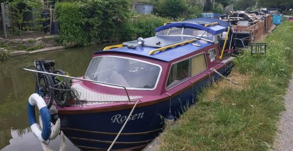

Try asking on the Thames forum, they might have a better idea of what such a river boat is worth. But my gut feeling is over priced. Look at what else is available, do a lot of searching on boat sales web sites, gumtree and marketplace. For a price comparison you can look at boats anywhere even if way too far away to actually consider buying.

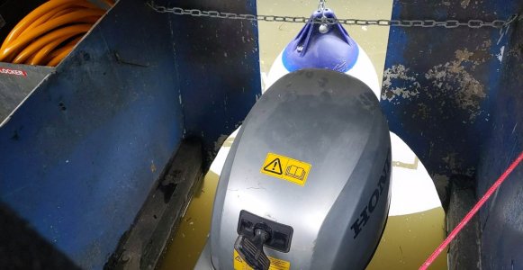

I see it has an outboard engine, good in that it should be easy to service and cheap to replace if it needs it but will be more noisy in use than an inboard. But I would not want such a boat with a 50 year old original inboard engine.
In a river or canal not much need for antifoul.
Firstly, Fibreglass seems to be immortal so donlt warry about the age. Condition is what is important. I would have thought about £2,000 would be nearer the mark for this boat. As said, donlt buy the first bot you see. There will be better and cheaper boats to be found. There always is. Don't rush into your first purchase. You have started well by asking your questions here. This is an exciting time for you as a first time buyer but be prudent!
its not so much the fibreglass that will wear out-fibreglass will probably last forever , its the fixtures and fittings...... unless its had a complete overhaul -its not worth it in my opinion. spend sometime looking at what else you could buy for that money , do your research and find somebody who knows about boats to go and have a look at with you.

Would not worry about the life of the hull, but all the bits inside it. Provided it does not leak and all the equipment works then with regular maintenance and replacements it should go on for ever. Boats die of neglect, not use. Looks like it has a modern Honda 4 stroke outboard which is normally reliable and easy to service. Unlike a seagoing vessel there is little expensive equipment, just the engine, steering and domestics (cooker, lights fridge and so on). Look carefully for leaks around the windows as a damp interior soon rots fabrics and ultimately the wood used inside.
The purchase price gets dwarfed by running costs over time. More important is to be sure of secure mooring for when you are not using it. Again unlike seagoing vessels the bottom does not get fouled, but suspect there is value from time to time of lifting to check the bottom. Ask around other owners. Whether the price is right depends on what else you can get for the money. Does not seem excessive to me if everything works, and despite what others say it is not easy to buy boats on the canals in decent condition. Your choice is limited to those close to where you intend keeping it as, although many canals are connected moving boats from another part of the country is a slow job.

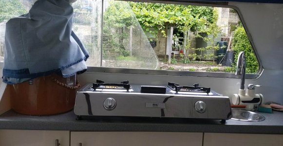

Key bit is the condition of the engine, but it does sound over priced. The interior is sort of tidy, even if the 'cooker' is a cheap camping one.
