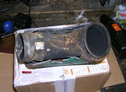

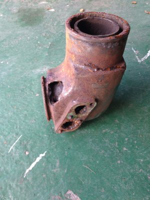

The cast iron exhaust risers will crack if any residual water inside freezes. Had two risers crack on 4 cylinder petrol Mercruisers many winters ago.
The boat was ashore on the hard at the time.
Not a complicated job to do but fiddly (at least on my engines) simply due to lack of space immediately around the 4 bolts securing it.

Thankyou, I understand the risers cracking if frozen. But I don't think that they have oil in them, so how would the water get into the oil?

Hopefully someone better than me (a mechanic) can offer an explanation but the exhaust manifolds mix exhaust gases from the engine with water cooling. You may have corrosion or a crack in the manifold which is bolted to the cylinder head – hence the oil.
Other than that it is possible the head gasket may have failed then it’s a compression or leak down test.

Thru the exhaust valves if they crack .
You might have also a cracked block due to freezing , many many raw water cooled engines died that way

As mentioned, if the leak is from the risers the water will run down ibto the manifold and there is always at least one exhaust valve open so it will run into the cylinder and eventually the sump. Was the water mixed with the oil like mayonnaise or just sitting seperately in the bottom of the sump. If is mixed then you need to get fresh oil circulatind round the engine as the water will rust the hardened finish on the camshaft. If its seperate from the oil then pump out and rinse it out with diesel to get most of it out, then the engine needs to be run up to normal temp to boil off any remaining moisture. To get the the rubber exhaust hose off spray around it with wd40 or similar and slide a long thin screwdriver down at different points to break the seal, then, look into the exhaust ports to see if there is any rust.
