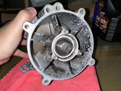

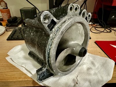

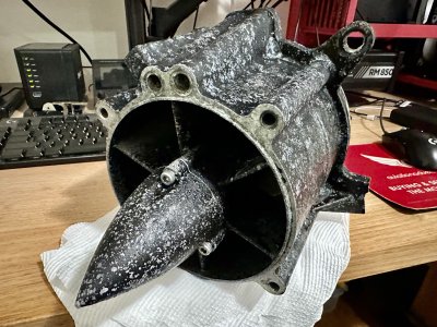

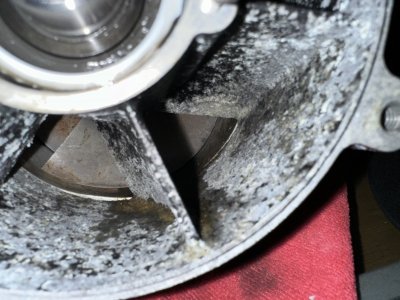

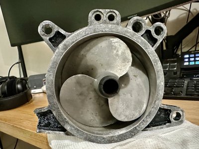

Sat the jet pump in a bucket of Calcium, Lime & Rust remover and gave it a light scrub this morning. Managed to get the drive shaft out of the impeller, which was rusted in solid. Next will be to remove the stator cone, to try and undo the impeller shaft. If I am successful, I will then be able to tap the shaft and impeller out of the housing.
Some photos of the unit after soaking in CLR. Am now disassembling the unit to components, however, because the stainless wear ring has deformed due to dissimilar metal corrosion, the impeller is seized and going nowhere. Need to do some more thinking. My understanding is that the impeller unscrews off the shaft that is retained within the Jet Pump. My concern is that the impeller blades will be damaged unscrewing it as they will be forced over the top of the bulge in the stainless wear ring. But, I see virtually no alternative.

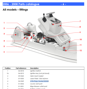

Hopefully a fellow Williams TurboJet owner can help me out.... what does the 2 pole plug to the right of the drivers seat do? Number #4 in the diagram below.
