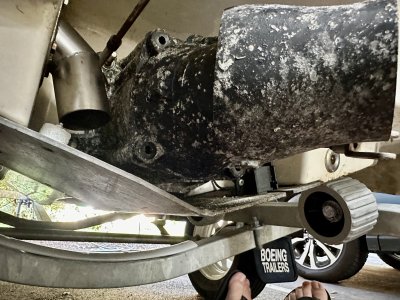

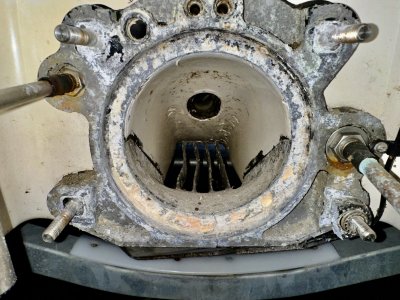

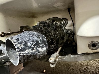

Williams 285 Jet Pump rebuild… anyone have any tips or advice before I get stuck into this?

Firstly does it not work it just not look nice ? You must have left it in the water for a long time !
The only tip I would say is just buy new parts from Williams. The pump is not a housing and impeller so the change over will take an hour or so.

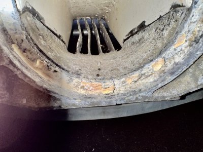

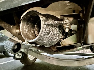

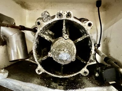

We only recently purchased the 285 TurboJet from Facebook Marketplace. The previous owner must have left it in the water long enough for it to be covered in shell-growth. I have the princely sum of $1,000 invested into it and the aim is to restore it and use it as the tender for our 45ft Beneteau FIRST.

They are aluminium so I suppose once corrosion sets in that will jam the impeller.
Assuming you can get it apart I would clean it off and before anything put it on the boat and see if it works. If it does then remove it again and make it look nice.
The original would have been anodised and I have no idea how expensive / difficult getting it re anodised is.
The only thing that will stop it working is too big a clearance so whilst you need to clean it up don't get to aggressive
There is also an anode that in normal times lasts forever as the boats are not on the water long enough to need it but if it is missing then I would replace it
