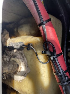

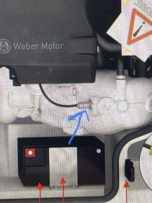

I cannot attach a picture but would like to understand what this part is, from memory it is missing! On the manifold, near the top facing forward, It has a sliver fitting then black cable / pipe and goes into the port side of the engine. on the forward side of the manifold? Could be a temp sender, think it’s snapped off!
Regards
Adam
You need to attach a picture I have no idea from the description. If a sensor is missing the engine will not be happy.
Hi sorry I didn’t see the option to attach an image! I do now.
So the part in picture is a second lambda sensor, mine has been cut off. Now discovered when the ECU is updated that second sensor becomes obsolete.

That is correct. Only one is active. The one furthest from the engine is not active.

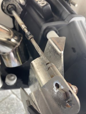

1, The small gasket part on the jet bucket control rod in photo, I need to replace, could this leak into the boat by being worn?

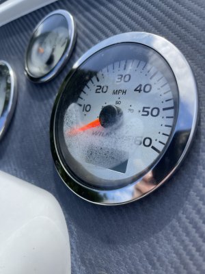

4, The speedo and Rev counter, they are in good condition and both work, the have a little condensation, is this an age thing or will new also suffer from this.

1. No that just keeps salt water out of the line to stop it seizing. You say you need to replace it ? Just call Williams. It is a pig of a job and they have a special tool. Your steering is seized I assume

4. They all mist up. Eventually they fail

It’s on the jet bucket control rod, it’s still nice and smooth, I thought I would be able to just purchase a new black gasket rather than replace.

Will just wait until the gauges fail in that case!
