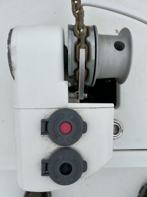

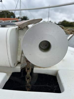

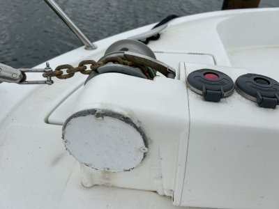

Antares 760 windlass, Quick I think does not appear to have a clutch. I don’t have a manual, can someone please advise if there is a manual clutch in order to free drop the anchor without the engine running?

Many thanks Plum, you have come to my rescue yet again. Excellent tip about removing the handle before switching on the power 👍, thank you.
