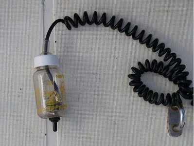

It once happened to me, I have a cut-off switch for the windlass I usually keep off except when using the windlass, those days we were frequently changing anchorages I let the breaker on., the anchor can operate even if you are not on the boat,
I suddenly heard the grinding noise of the windlass rising the chain and ran to cut the breaker. On inspection, the bow command switch watertightness was long gone; I had to make another one with the locally available means
![biberon.jpg biberon.jpg](https://ybw-data.community.forum/attachments/128/128449-2cf93f4561fbae2197b7151e3240a328.jpg)
