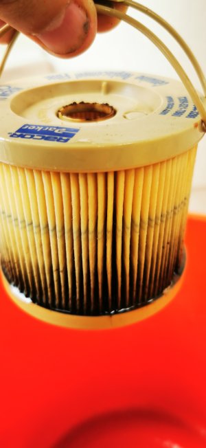

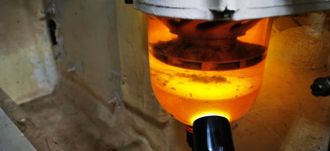

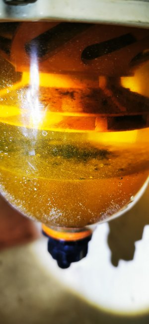

Hi all, check air filter today and flap in air filter box - both don't seem to be the problem. Air filter is somewhat dirty, will be replaced as annual service comes up now but there is no emgine oil in filter nor in air filter box.
However, my primary filters had up to 50% of the bowl filled with water and diesel bug was smimming on top of it. They had been changed 1 year / 40h ago. Secondary engine filters haven't been changed 1year ago and are therefore coming to 2 years but below 100h. Racon 500 uses 10 micron filters of which the bottom 30% was blackish
I now suspect the earlier mentioned fuel starvation due to diesel bug in primary and possible secondary filters. I will change and clean the filters and hope that's the solution. Any thoughts of this could have been the black smoke issue at higher engine load? Low engine load I don't got black smoke.
