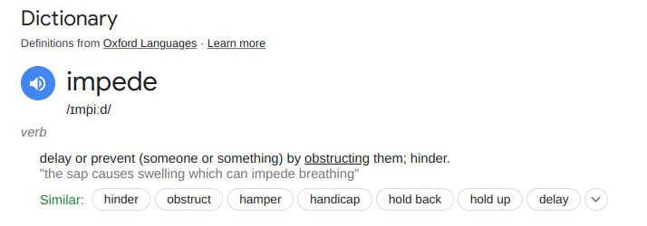

Might help if you substitute some of the words from Martyn's post, eg 'hinder' or 'obstruct'. Similar enough. Ie. 10i fishing boats are required not to get in the way of ships (ie fishing boats are give way in a TSS), but 10j is different - sailing vessels can expect the usual stand-on/give way rules to apply, so long as it is not putting the other vessel in danger.

The question is not the dictionary meaning of impede, which everyone already knows, but the meaning of the seemingly ambiguous rules 10a and 10j. Try having a go at explaining that.

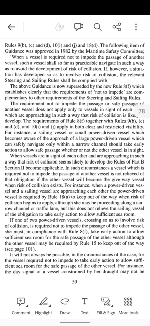

From Cockcroft and Latimer's guide to collision avoidance rules. Not to impede - navigate in such a way to avoid the development of a risk of collision. Not to impede passage or safe passage - take early action to allow sufficient sea room for the safe passage of the other vessel.
If risk of collision becomes apparent then normal rules apply.
If vessels still hit each other then no one will be blame free!

The Cockcroft and Latimer's guide quote is interesting. It appears that there is a distinction between 'impede the passage' and 'impede the safe passage', the former being defined, but the latter isn't.
However, since it goes on to say '
'When vessels are in sight of each other and are approaching in such
a way that risk of collision seems likely to develop the Rules of Part B
Section I1 become applicable'
I don't have radar, although the development of AIS perhaps makes it more realistic to identify very early targets, maybe making it possible to be in the 'shall not impede' phase (whatever that means), but my personal experience with dodging particularly Channel shipping is very much in sight of each other (unless limited visibility), and therefore in the more normal COLREGS phase.
http://kashti.ir/files/ENBOOKS/Collision Avoidance Rules Guide 6E.pdf has a bit more in the rule 10 section which refers back to this. It looks as though the application is defined by case law, not by the regs themselves.
