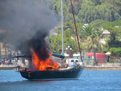

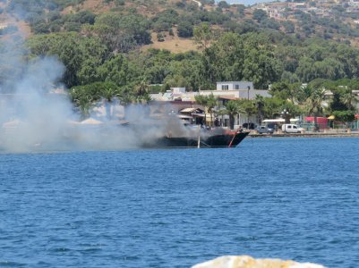

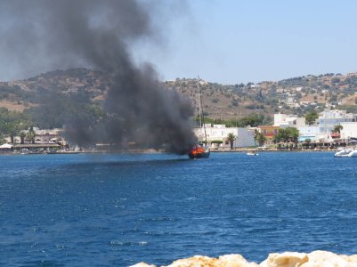

The SFIA insisted on all sorts of fire protection: fireproof resin finish in the engine space, gas, fine water spray, metal pipework (even though there has to be a flexi connector) etc, but in the end on the firefighting course we were told "With GRP, even if you've got all this firefighting stuff just get out a mayday and get off as quick as you can"
We watched a boat burn to a total loss in Leros. It was anchored with nobody aboard. We first noticed the smell of burning GRP about 2-3 minutes before I took the first photograph. The three photos shown here were taken at 1024, 1026 and 10 39. The cause was almost certainly electrical, I have no idea whether seacocks were left open or of what type they were. A dreadful indication of how rapidly fire can destroy a boat.
Later that day the wreck was dragged ashore and the remains cut up.
