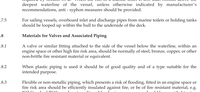

Code says the following. Non brittle is the debatable term.

The code only prohibits it in the machinery space but you are right it would be unsettling if it was a thing.

As “machinery space” covers 6 of my 8 seacocks I did DZR/bronze for the lot.
I wouldn’t have if I wasn’t coding.
Thanks that's useful and would seem to be open to interpretation since TruDesign would argus that theirs are "other non-brittle fire resistant material". They certainly can't be described as brittle, especially with the load collars, and they've passed various fire tests so I wonder if it's time to start pushing back a bit harder on surveyors who are covering their own backsides. Perhaps even start mailing such survey results to TD for official comment.

Many of those, certainly more premium brands, now fit TruDesign anyway. Those that don't are fitting DZR cocks on bronze through hulls so the days of truly dodgy seacocks are gone, but from everything I've seen TruDesign are fully compliant with all of the regs. That's why I keep asking for specifics on threads like this, if there truly is a problem then we should be able to get some justification for it from someone. Yours is the closest I've seen but even that doesn't actually say not to use them.
