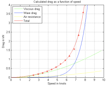

The attached graph is for my boat, so yours will be a bit different but the principle applies: you will have twice the resistance, so see what reduction in speed you can expect. So in my case, if I motor at 6kts normally (at x rpm) which is a drag of 1000 Newtons. 500N is at 4.5kts which gives the speed with both boats at x rpm. Not an exact calculation, but a reasonable approximation. Better than a hand waving 'allow half the speed'.
Sorry but theory and practice ??
Once a tow is underway - the speed can actually creep up over time to a reasonable % of usual speed .... done it - got the T shirt ... without need of fancy theory tables / graphs ...
