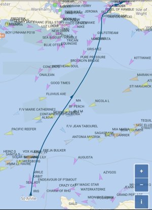

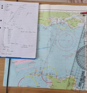

If anyone has doubts about forecast tidal streams and coefficients, I recently crossed the channel Alderney to Fairway/IOW.
I worked out effect of stream for the crossing and came up with a CTS of 010 degrees. I was curious how it would work out so I set the autopilot to 010 and trimmed sails/ran engine to motorsail to hold min 6kts on that heading.
The AIS track shows it delivered us to the right spot after 8 hours. I didn't adjust course at all during the crossing, even the shipping lane traffic left suitable gaps for me as if by magic.
Faint pencil marks previous crossing. Hugged coast into Solent avoiding worst of foul tide.
