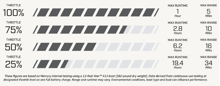

I found this table from Mercury giving range at different throttle settings very interesting.
That table/presentation is a bit strange to me.
Assuming it refers to Avator 7.5E then it has an 890W input motor, 750W output (hence presumably the 7.5E name), and 1030Wh battery.
- Based on that at "full throttle" it should run a bit longer than 1 hour, more like 1hr 10mins or 1.15hrs to use their format.
- But then at "75% throttle" they claim 2.8hrs which would mean (1030 divided by 2.8) about 370W which I'd call "40% power" definitely not 75%.
- And at "25% throttle" apparently it lasts 19.4 hours but to run for 19.4 hours you'd have to use only 53W or about 6% power. Not very much at all. 53W might push that boat, I don't know that boat, at 1.75 mph but it certainly wouldn't push a 9ft inflatable dinghy with 3 people in it at that speed (the 1.75 number comes from 34 miles divided by 19.4).
OK the battery might last a bit longer than my numbers at very low outputs but to claim "2.8 hours at 75% throttle" might mislead some potential customers... one could interpret that to mean it has a battery capacity of 1869Wh (which it doesn't).
The Avator 7.5E looks great but it's quite physically big and actually has a bit less power than most of the "1kW class", at around £2400 inc battery. For comparison the ePropulsion Spirit PLUS is £1875 (1kW power, 1276Wh battery), and the Torqeedo 903 is £1650 (900W power, 915Wh battery). So no in this case while it's providing more choice it's not really providing (price) competition!
As an aside all the manufacturers do this to some extent, ie claim ridiculous ranges at ridiculously low speeds for very easily-driven boats on a flat calm lake. But as a good working generalisation you need about 500W (Watts) to push a typical inflatable dinghy with two people in it at 3.5 to 4 knots. The maths is then fairly easy if you know the battery capacity in Wh (Watt hours), but we're always happy to give you a "real world estimate" for your use case if you phone/email us.
