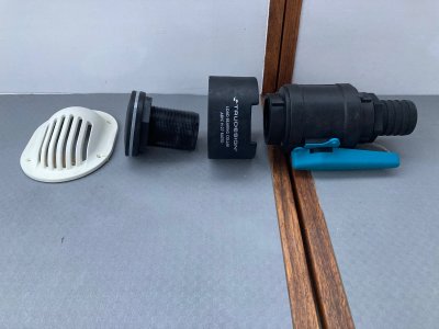

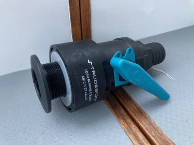

I may have missed the boat now, but here's the photos I said I'd post of the Trudesign components. The tricky bit with the support collar is cutting down the thread on teh skin fitting so that the valve screws down far enough such that the colar bears against the hull surface to provide the extra rigidity.
I haven’t got the collar..I’m going to install it next time the boat is out the water…the fitting is in part of the lazaret that no one would go near so I am sure the fitting is safe.
It looks like you are doing the engine water intake…that one I will leave to last as it’s the biggest job…my plan is next year to change the shower outlet and toilet inlet…I might have to get creative because they are in a tight position under the bathroom.
Thanks for your imput…look forward to the rest…especially your technique for removing the old fitting
