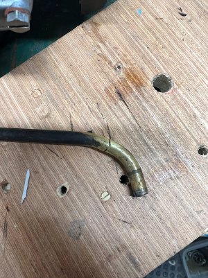

Success! Well, sort of…. It was bugging me that it felt tighter to turn over, I removed the plug to eliminate any compression effect and it was still a bit tighter than a felt it should be. Removes the bottom end of the leg and it the while gearbox felt tighter than I expected. Put the engine-less-gearbox end in the water bucket and it fires up instantly and purred lovely.
Stripping the whole bottom end down I can’t see anything obvious, maybe it was all gunged up. Bearing runs freely, bushes seem smooth and not binding.
However, I’ve now created a new problem when removing the bottom end… the water pickup pipe didn’t release itself from the top of the pump, instead it fractured at the top. It looks like a simple brazing job and the power head came off super easily so it will get a good going over whilst it’s in pieces. The only thing I’m not sure about is the angle on the top of end of the pickup pipe, but I’ll have a look online to see if I can find some pics.
Thanks to all who commented.
