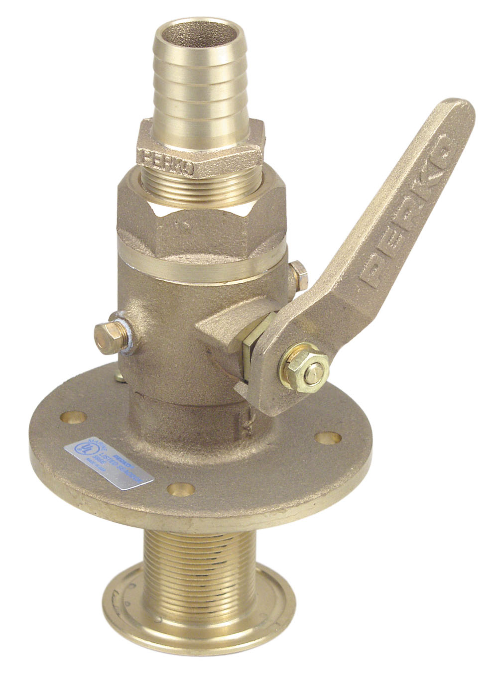

Finally a bit of an observation. I understand that the BS test requires a leak free period at up to 200psi . In your video that appears to be on a smooth walled spigot without any barbs. Is this so? In a real world scenario I couldn't envisage anyone really maintaining that level of energy simply by the compressive force of a clamp in that way. Further it has always been my understanding that the 'seal' on a hose on a spigot is actually between the barb lip and the hose internal wall which is or should be sufficiently pliable in order to 'settle' around the lip. The hose clamp then has a different function and that is to exert sufficient pressure so that the hose does indeed settle around that lip and also that the diameter of the inner wall of the hose is such that its 'smaller' than the barb and hence the hose cannot slide off the spigot. If these assumptions are right then the 'ultimate' clamping force is almost irrelevant in day to day use and a moderate pressure applied to the hose just in front of the barb will suffice for almost all situations (thinking of the spiral hose failing here) would you agree?
As you point out the barb can have a fairly significant impact on the actual seal. But then so does the design and material of the hose.... The only way to get a repeatable test to see if the clip is any good is to remove those variations. Which is why the test is as it is.
As to the interaction of spiggot and hose.... The short answer is "it's complicated". The interaction depends on the size of the barb, the stiffness of the hose and the pressure differential on either size of the spigot.
For example, if you consider the extremes. One extreme is that the barb is fairly small, the hose soft and there is little pressure differential as the seacock is open and fluid is flowing through. In this case there is a good seal between hose and barb, and little pressure from the fluid to pass the barb and approach the part of the hose actually clipped to the spigot.
The other extreme is a large barb, a stiff hose and high pressure on the hose side, with the spigot valve closed. In this case, only the stiffness of the hose is holding it to the barb, so it does not take a huge amount of pressure to force fluid past that and into the gap behind the barb, which with a stiff hose is probably a void. In this case you are then relying entirely on the clamping force of the clip to hold the pressure back. And with the hose clip also having to pull the stiff hose down from the barb to the clamping face, you've also made its job tougher.
This is why barbs are generally fairly moderate. And in any case you don't really find what I'd call barbs on most through hulls. Just ribs. Really speaking you are very much relying on the clamping force of the clip.
