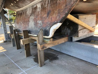

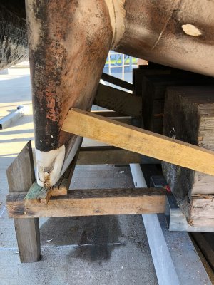

The keel has been supported on jacks - but now a wooden frame made - so we can cut / grind / do whatever and keel stays aligned.
Called in another Boat Repair guy - retired guy who I've known for years ... usually he wants to sit and relax ... but agreed to come have a look.
He was intrigued by the idea of tank space in the keel - which l;ed him to suggest using that to strengthen keel to hull ....
Basically cut out top of keel inside hull ... then resin wide strips to hull and then down into the keel space, Once done - re-glass over the keel top sealing it back up. His idea being use the keel space to advantage.
I can see his point and now we are devising a compromise of his .. our ... and other guys ideas ....
