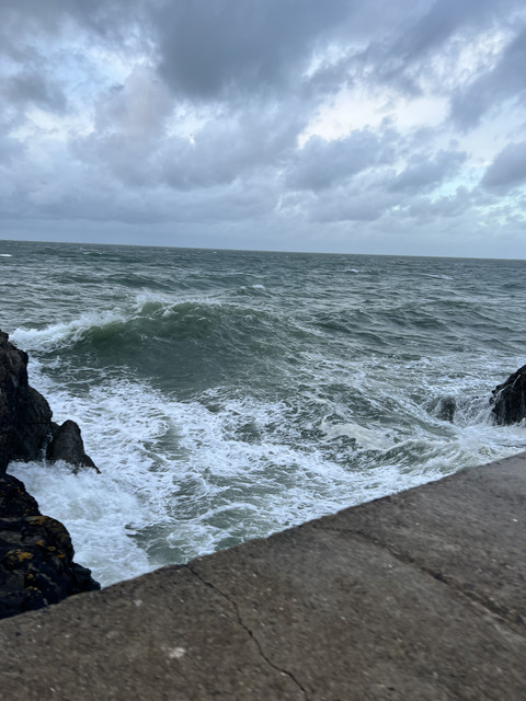

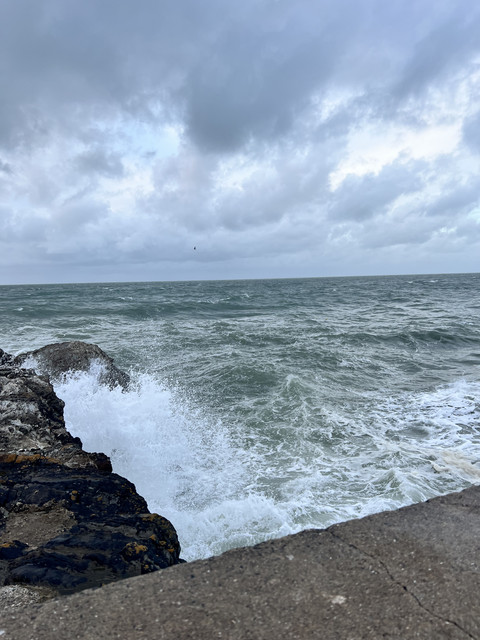

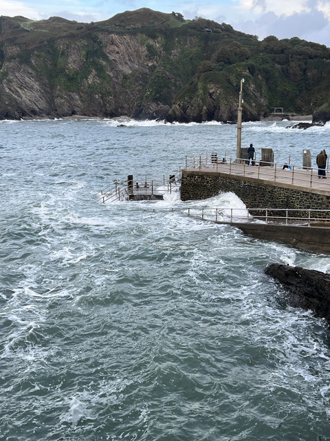

Looks like tying her up in the inner harbour was a good idea after all, the bad weather has started to roll in today (forecast 2.6 meter waves).
The RLNI mooring bouy looks like it had been pushed over towards the rocks, with the length of line attached to it I’d have certainly been smashed up on the rocks!

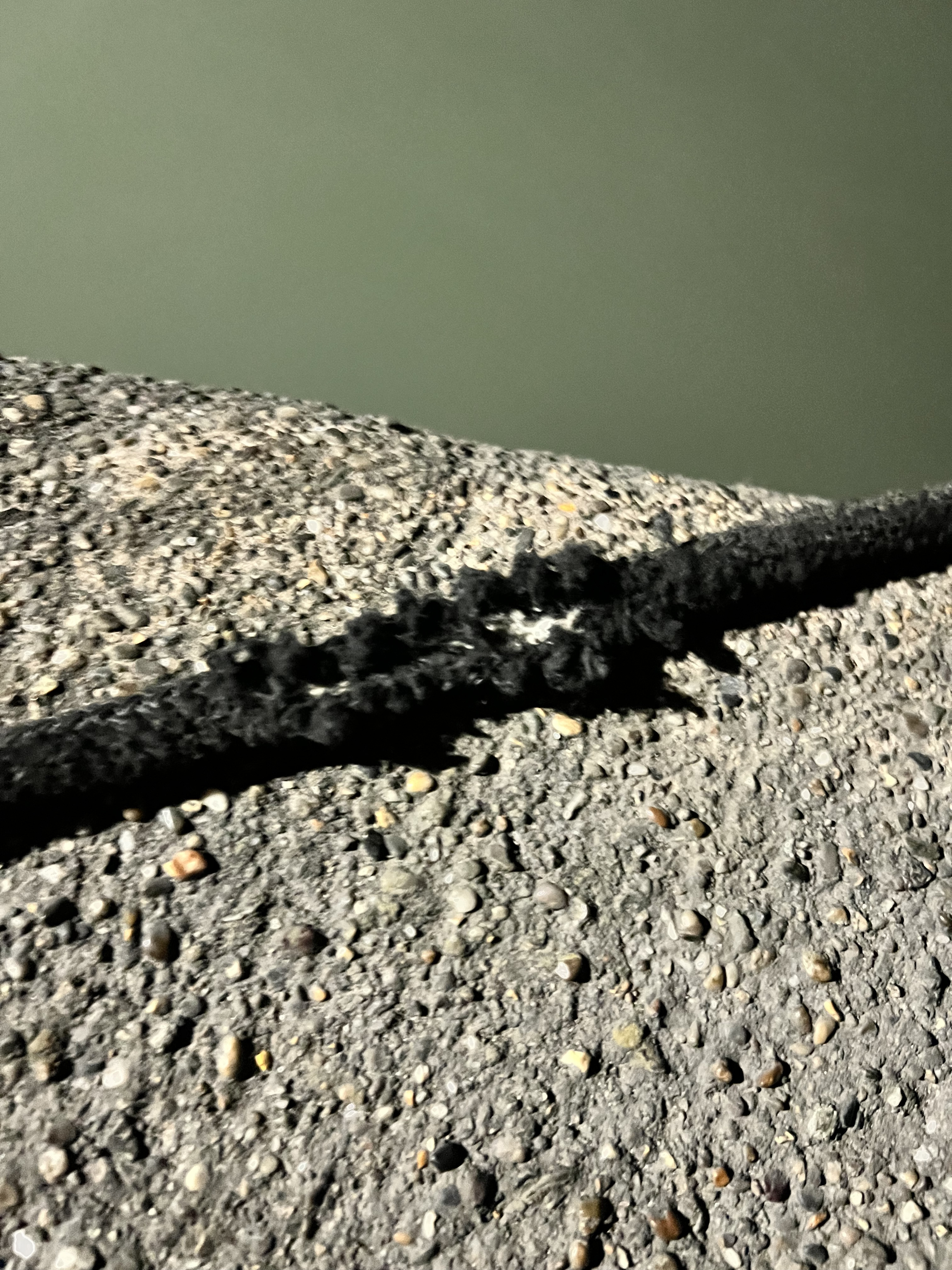

This has very much been a learning experience for me too and I’ve experienced the exact same!
I decided to check the lines earlier thinking because they’re rested and pulled tight over the stone wall that they might chafe, lo and behold they’ve chafed!
The lines are pulled tight because the tide is out and the boats taken to the ground so it’s difficult to get anything underneath it to protect it. I’ve run another line to the bow to fix this but I need to come up with a solution to prevent this from happening again.
Thankfully the other lines seem fine but I need to find something to protect them with.
I’m thinking about cutting up and wrapping them with an old ratchet strap and just duct taping it all up to hold it in place.

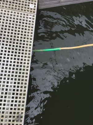

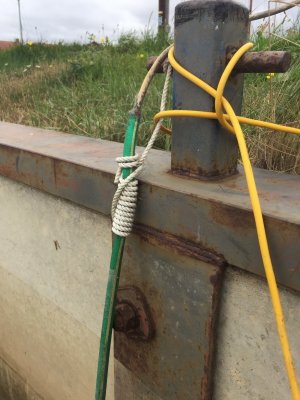

Cost of warps‼️
Suggest yo get some cheap garden hose, cut it into suitable lengths and put a small hole in the hose wall at one end. Then tie a short length of light line to the hose through this hole.
Feed the warp through the hose, place the hose where any chafe can occur (fairleads, walls etc.) and tether the hose to the warp to stop it moving.
Use same method with electrical shore power lines to prevent impressive firework displays.💥🔥
As you see, I am protecting my shore power cable from chafe and salt water.
Must have a word with my new neighbour before his power line saws through. Fortunately we are on a pontoon so the problem is not so immediate.

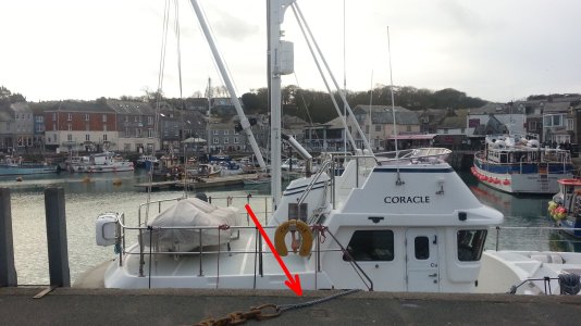

I haven't commented previously because I could not do anything practical to help, I am too far away, but I have followed your posts and hope things go better for you from now on. My only comment on your next steps is that you might consider Portishead as an alternative to Cardiff, but you really ought to have someone on board who knows the Bristol Channel.
This seems like the best long term solution and something I am going to invest in at the end of the month but for now I’m going to bandage it all up!
