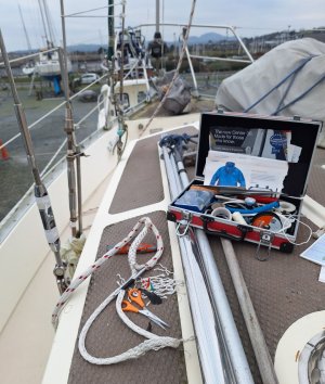

I just put a new splice on my genoa halyard as the original was starting to show wear and UV damage. Much harder to splice in a 5 year old well stretched rope, unless you reverse it.Loosening the outer braid helps. With new rope it's much easier. I still use a book but only for reassurance. One of the keys is how much to feather off the outer casing. Marlowbraid defeats me though. Anything out of sight aloft gets a whipping in case. Dyneema is OK with practice. Plenty of online info and tutorials.
Freezing work and I needed a drink after that....!
If you want practice, make some fender lines spliced to the fender eye. Looks good, useful practice and shouldn't come undone.
