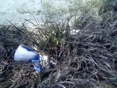

As I indicated earlier, the steel Spade is an excellent anchor, but its Achilles heel is thick weed. The bulky balast chamber struggles to penetrate thick weed.
Below is just one example in a small patch of only mild/moderate weed where the anchor is struggling to penetrate the weed bed despite being given every chance with a reasonable setting distance and adequate scope ( 8m @ 4:1).

Interesting. We find that our Spade performs exceptionally well in weed. Lots of reverse engine thrust and the anchor will penetrate through the weed with the sharp tip. We don't have an oversized anchor, so that probably helps penetrate the weed.
Maybe depends on the weed. I bought the spade because of seagrass in the Med. Made no difference. But if there was no weed it would hold a cruise ship.

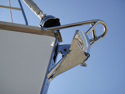

Our Spade anchor is now 10 years old and still looks exactly the same as the photo. I felt that investing in the stainless steel version would work out cheaper in the end, but I'd probably need to live for 200 years before breaking even. It does, however, look wonderfully bling on the bow, and it has never let us down; first time, every time setting, and never dragging...
