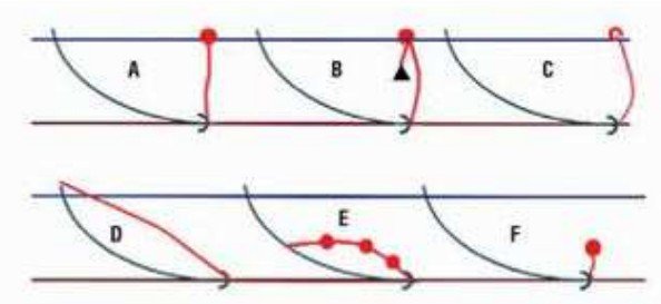

Now I read about using a trip line to rescue the anchor if it hooks in between some stones on the ground.
Therefore I would like to ask you politely for some advice regarding an anchor trip line:
  • recommended length?
  • line diameter?
  • best attachment point on the anchor?
  • should it be a heavy sinking line or a floating line?
  • with a buoy or without?
What are the risks or dangers?

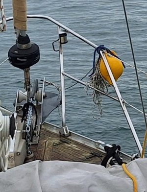

I often use a tripping line with buoy, less because of rocky bottoms, more because of the risk of discarded or active moorings. I adjust the length so it is just more than the water depth at HW by taking a hank of the slack just under the buoy.
I use an 8mm line that sinks. Some use a floating line which makes sense as there is a risk of a sinking line getting tied around the anchor or chain in calm conditions. And I will probably replace with a 10mm line for my 20kg anchor.
The anchor should have a hole or eye at the front to attach a line. I use a bowline
so the regular retying avoids chafe in one place.
I anchor often and am used to setting and recovering the line, taking care to make sure the line and buoy are not tangled in the chain. The buoy and line are left rigged as in the photo, and I normally anchor in about 6-7m HW so the line is rarely adjusted.Screenshot_20260403_154110_Gallery.jpgScreenshot_20260403_154032_Gallery.jpg
I have not yet used the line to recover my anchor from the bottom, but I have been caught on a large discarded rope and an old chain. Both times I could lift the anchor (with the winch) and then use the tripping line to free it.
I detest having to rig a tripping line, because of the potential risk of fouling it on rudder or propeller. There are times when I do use one, particularly if I know that there is liable to be old discarded gear on the seabed. I avoid anchoring on rocky ground. On balance, I would favour method "E" in Roberto's post (2), but admit to using "A" for simplicity. Best avoided by anchoring on clean ground, ideally by seeing through the water, and if not, by using a fish finder.

Where have used the trip line we use System B in the diagrams posted above. Light non floating rope attached to anchor, up through medium sized shackle on the buoy, and back down where we have tied an unused heavy anchor swivel to the end to act as a weight. We adjust the length of rope to a few metres more than HW depth to avoid the weight hitting the bottom. Seems to work OK, and the weight helps keep the buoy roughly over the anchor and no floating line.
