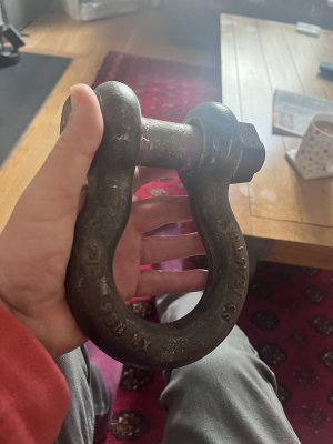

A very simple but remarkably effective system is to have a massively oversized shackle on the end of a piece of rope. A shackle large enough to run down over your anchor chain and over the shaft of the anchor to its base where it joins the fluke. If you are unlucky enough for your anchor to snag, put the shackle over the chain, or anchor chain through the shackle. Have your tender or any other boat pull the shackle down and along the chain until it is tight against the base of the anchor. Then pull hard until the anchor comes out backwards. I have never had to do this but I have friends who have seen it work very effectively and simply.
Perhaps something like this?

Or a length of chain about 2 metres between two lengths of rope, used in exactly the same way. Mine has been used successfully a few times and has generated several.packs of beer when lent to others 😄

That's my plan, and I have large stainless ring I bought specially for the purpose.
Ultra make a really luxe (with a really luxe price) one: Anchor ring | Ultra Marine Anchors. Mine is much simpler.
