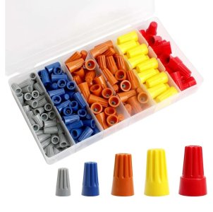

They may use those screw on things but do they meet a actual standard?
They were common in domestic wiring in the 1950's and early 60's. used to be called "Screwit" connectors and were ceramic. Haven't seen them used in the UK (or anywhere else) since about 63. I certainly wouldn't give them house room these days.
