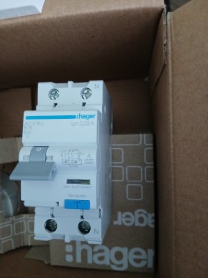

Well the RCBO arrived today.
I'll fit it next time I'm on the boat
