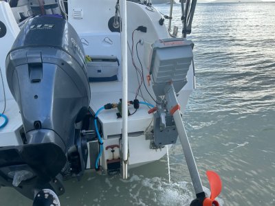

I've seen a few people using trolling motors on powerboats for fishing, had a chat with one owner who said he'd had his for a couple of years no problems, just rinse it and give the metal bits a sniff of WD40.

I paid £100 for my Bison secondhand, in as new condition. Then added a 60Ah lithium battery for £280. That battery has now become a useful extra to my main house battery, which has saved me a few times now.
Of course I could have spent £50 on a small car battery instead.
Torqueedo/Epropulsion seem to start at about £1500? So it's a very different proposition.
In defence of the bison, it is lovely to use. Always starts first pull. Almost silent. F/n/r which small outboard don't have. My wife and son both like it, it's much less daunting to use than a petrol engine. And with a 60Ah battery I have 1hr range which is slightly more than I get from a tank of fuel in my 3.5hp 2 stroke.
Maybe I will put it back in to use one day. I would want to find a suitable pelican case or waterproof toolbox to put the battery in, along with Anderson power connectors, and a battery monitor. The unbranded ones are under £50. So total extra cost not outrageous.
By the way, it's not hard to shorten the shaft on these motors- just unbolt the head and saw a bit off the tube, being careful not to damage the cables.
