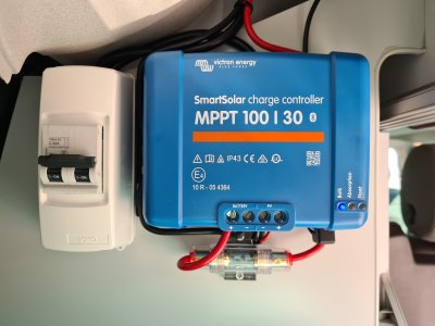

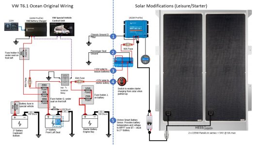

Connected my MPPT in the camper van to the solar panels with one of these. The panels were connected in series and around 320W in total.
The dual pole switch isolated the panels completely from the MPPT in the case where I needed to work on batteries or wiring in the van.
Due to the use of an Argofet between the charger and the batteries, the fuse for the MPPT output was on the MPPT end instead of the Argofet end. The Argofet outputs were fused at the batteries. See diagram.
To avoid the MPPT shutting off when the sun went down, I used the alternator energise output of the Argofet to power the MPPT when the solar array was off.
Works flawlessly and charged both banks of batteries from one MPPT without upsetting the smart-alternator or bridging the VW isolation relay during engine start when start/stop kicked in.
