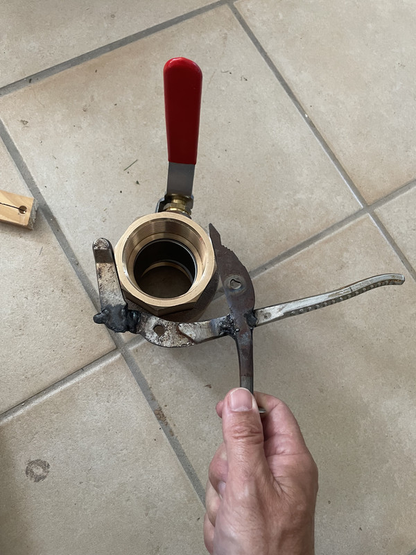

Yes, seven pages....I’m afraid to post a picture of my second 70 mm wrench in case it gets verbally abused for a further six pages. The lift out should happen this afternoon 😀

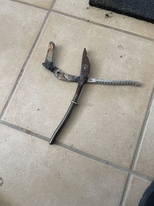

Ok, this is my second tool….it might look flimsy but it is made from a pair of grips (actually two pair and a bit of a mole grip),,,so it should hold…I was going to cut off the superfluous handle to make it more conventional looking then thought, what the hell, an extra handle might come in handy
But the real question you should ask yourselves is, how does he get such crude looking concoctions accurate to point two of a millimetre 🤔

Wait…there’s more…
Chances of that undoing the seacock is less the zero
