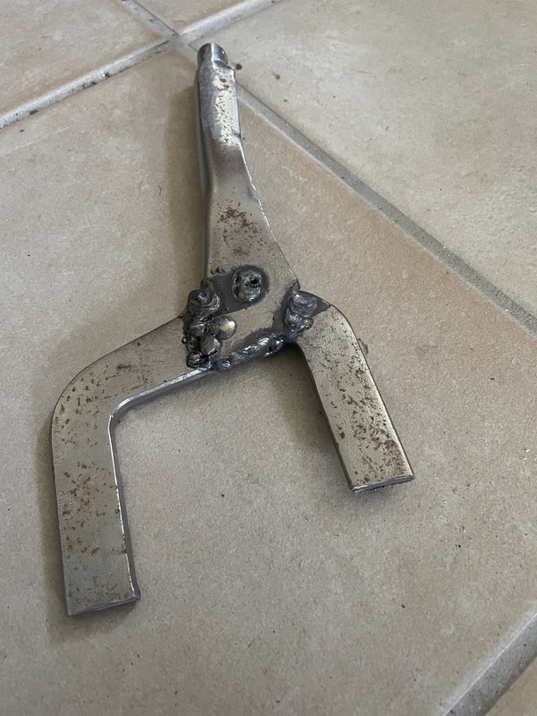

Seacock handle broke

A quick question for Bouba. When you gave the sea cock the welly it needed to break it, which direction were you trying to open it? I had exactly the same problem this week due to misplacement of the threaded rod visible in your images. The only way the lever could move in your case, was clockwise looking at the handle. The pin would stop any anticlockwise motion with the cut out in the handle touching the screw. This screw can be moved to the other hole to allow the handle to move the other way.
Once I unscrewed the pin (allen key) on our boat, I could move the seacock when originally, like yours I thought it was stuck. Has it ever been operated in the past?
I closed the existing seacock....and it was very difficult...I have opened and closed it many times so it couldn’t have been an allen screw. No one comes on my boat just to annoy me😱...
Then as I tried to open it it snapped
