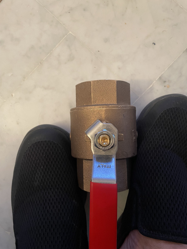

The only logical reason why you think you couldn't close the valve because of the stopper is that, looking at your 2nd pic of post #24, you tried to rotate the handle CCW.
In fact, the stop the handle is against to in your pics does not restrict the handle movement at all if you rotate it correctly, i.e. CW.
And mounting the handle as it is in your pics or rotated by 180° round doesn't make the slightest difference, in this respect.
What jfm said is 100% correct, and if you've been able to close the valve only after disconnecting it and reinstalling it upside down, that can only be due to one of these two reasons:
1) you tried to rotate the handle CCW before, and CW afterwards. I can't think of any logical reason why you should do that, but... Hey-ho!
2) coincidence.
Mapis, please, I understand that you cannot turn a handle that has reached its stopper…but it would turn the other direction either.,,.because that direction would open it further and that is impossible. Taking the handle off and replacing it 180 degrees allows it to turn the 90 degrees to close

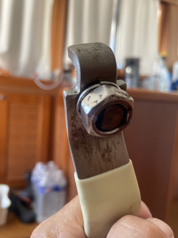

I will have one more go at this…
This is the old and broken handle..as you can see it is symmetrical therefore bidirectional
The new handle is not

Our boat had four struts wedged against the hull when it was in slings last weekend. It still moved a bit though, so I tied the ladder to the boat.
A quick question for Bouba. When you gave the sea cock the welly it needed to break it, which direction were you trying to open it? I had exactly the same problem this week due to misplacement of the threaded rod visible in your images. The only way the lever could move in your case, was clockwise looking at the handle. The pin would stop any anticlockwise motion with the cut out in the handle touching the screw. This screw can be moved to the other hole to allow the handle to move the other way.
Once I unscrewed the pin (allen key) on our boat, I could move the seacock when originally, like yours I thought it was stuck. Has it ever been operated in the past?
