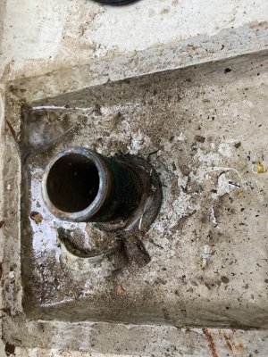

Knock a tapered wooden bung into the through hull from the outside and cut the flange off with a hole saw. Then unscrew what's left from the inside. Fit a new through hull, seacock and hosetail. Takes less than an hour, you know everything fits together, you know it's sealed and you know you won't have to be chocked up, costing more money and losing boating time.

I'd be even simpler .... take a grinder and carefully grind the outer flange off - in so doing also taking away all sealant and roughness that may be left ..

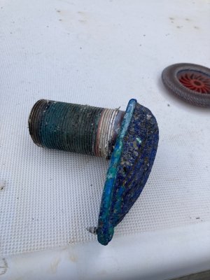

I just replaced all the through hulls in my Jenneau, and after a few hours of pissing about with spanners I just took a multi tool to it and sliced the valve in half. Took about 2 minutes.
I couldn’t easily cut it off from outside because it had one of those stupid strainer things on it.
Then stick a new tru design through hull in, sikaflex it up, put a tru design valve on top and back in the water.
You could do the hole thing in less than an hour.

I have told everyone, a dozen times so far....that if I can’t get the seacock off without damaging the thru hull, I will replace the thru hull.

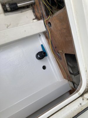

Had my boat on the hard a few weeks ago for anti foul etc. One of the jobs was to replace one of the 1" heads seacocks with a 1 1/2" seacock. I went for one of these : Forespar Marelon Seacock Valve (Through Hull / 1-1/2" Hose)
Used a hole saw, as i mentioned in '181, cleaned and sanded the surfaces, fitted the new assembly and was all done in less than an hour. Next time we come out i'll replace the others, was short of time this year.
