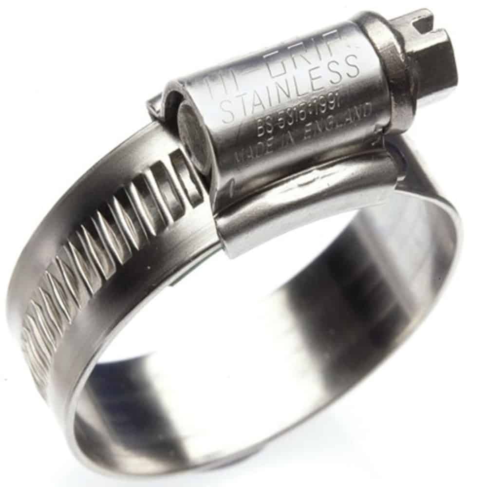

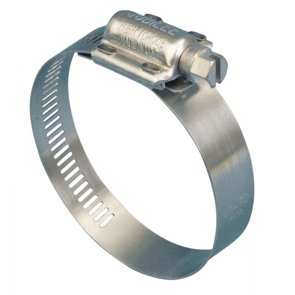

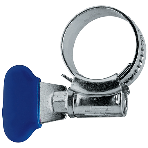

Regardless of the number of clips you fit, be aware that there are different designs and finishes (band thickness, cut-through vs. solid, rounded edges, material etc.).
