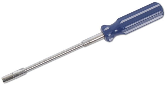

Don’t use a screwdriver. Use one of these:
I used to use a 1/4 drive 8mm socket and a ratchet but the above is even better in most places. They’re slightly flexible too.
I used a ring spanner, it fitted the space better and I could ‘feel’ it onto the nut better. You can’t see and turn the things at the same time on a Dragonfly, if you’re a normal adult.
