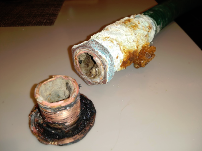

Even when you think you have closed them they can corrode so that the open port enlarges and does not completely shut off when the lever is in the closed position. You are then depending on the pipe seal and a good height loop of pipe above sea level to keep dry !

I've only ever had one seacock fail in a way that would have been serious, and no amount of clips would have helped
Fortunately, it was while I was replacing it, and the boat was out of the water. I knew it was bad when I bought the boat, but I didn't realise it was that bad!
