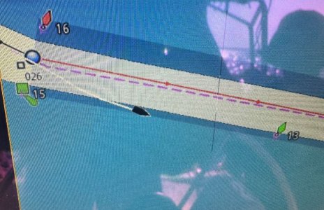

Hello - I have a Hunter 310 with a well functioning Autopilot (Raymarine ST4000(+?)) - not 100% sure if it's a (+) or not;
When going from Standby to Auto, the boat stays perfect on course;
When giving it a way point from the Simrad Go9, it goes straight to that waypoint and asks for cancellation once the waypoint is reached.
When setting up a route on the Simrad, then sending the route to "active" - each waypoint is being transferred to the ST4000 right on time, acknowledged there and "activated"...
The problem I have is that every time the "new" waypoint is changing course, the autopilot is not reacting for a long long time, it way overshoots the last waypoint until it finally starts to put some course correction in for the new waypoint.
I have played with the arrival circle and the max off track width (not sure the correct terms as unit is not in front of me) but nothing has helped so far....
Any help is highly appreciated...

Thank you earlybird, but I don't recall that being an issue (but will check once back on the boat. Once the previous waypoint was reached, the next one auto-downloaded to the ST4000 and without doing anything it eventually slowly started course correction, simply waaaay too late and too slow.... as can be seen in the picture... that course was plotted without any human input...

Thank you Peter - these are in the ST4000 I believe and I have tried tightening those up with next to zero impact on the problem... Reading earlybird's comment again, could it be that there is a "time until auto-confirmation" of the next waypoint occurs possibly?

Thank you earlybird - it definitely does make sense what you're saying - AND I will promise to confirm and come back once I get back on the boat, which should be in 2 weeks or so.... for some reason I recall it advancing to the next waypoint on its own for one night of sailing..... (there were drinks involved, so that's what makes the judgement a little hard).... will report back...
