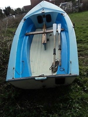

1. what is the name of this model / manufacturer
2. when where they built
3. are they all GRP or is there some hidden plywood - have seen GRP Enterprises with a plywood forward, I presume this doesn’t have this sort of construction
4. any issues with this type of enterprise

Unless I’m mistaken, they are Hartley 12 dinghies made by Hartley Boats of Derby and are still built. See their website. I don’t think there is any wood in them.

Bahia by Laser. Topper also do a similar rotomold thing (can't remember what it is called).
They are popular with sailing schools because they are simple, stable, and virtually indestructible.

The bottom one is a Laser Bahia.
According to the logo on the bow anyway.
There is a bewildering variety of designs from the last 20 years. Plus all the others before that.

There aren't any Enterprises in your photograph. The bottom 2 are both rotomoulded boats, possibly both Laser Bahias. Rotomoulded boats are very rugged but heavier than equivalent fibreglass boats and have less interior volume. The second from top looks like a standard Laser singlehanded dinghy, possibly a Laser 11 2 man dinghy and the top is probably the later version of the Laser 11, called a Laser 3000.
As regards an Enterprise for cruising, you will be told they are more unstable than other heavier dinghies but if you have a reef fitted to your mainsail you will find it will perform well and be quite manageable, I did this with a Lark and cruised quite happily in it singlehanded.

Sorry one and all, this was my first post and I somehow
This is fingers crossed what I wanted to talk about

Hopefully my picture of what is a Holt GRP Enterprise should be posted before this. Sorry again fo the wrong picture. Is there a way of post a picture without the whole url thing?
