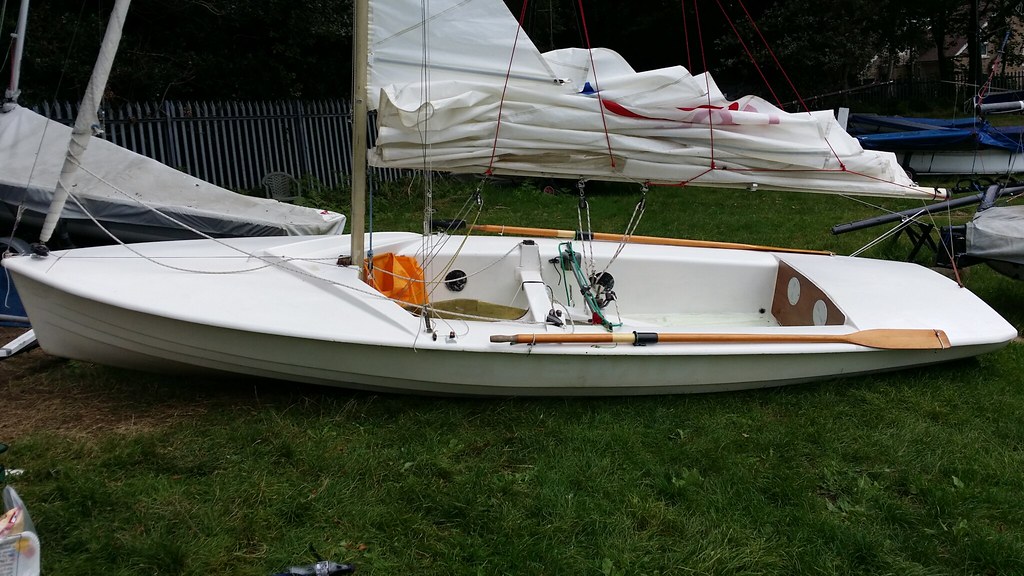

I am a newbie and by error attached the wrong picture, I have tried to post the correct one but they all appear to have been getting lost.
Hopefully this will post instantly as my last one did. This is the Enterprise I am interested in, stiffness, issues etc etc
