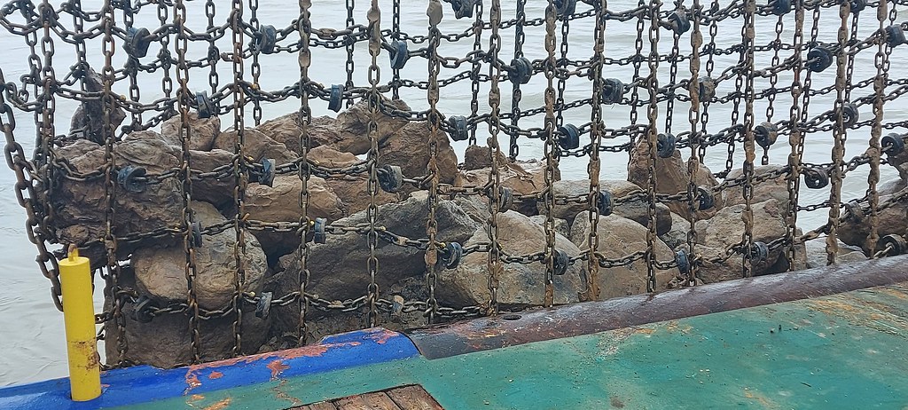

Kind response and image from the Harwich Harbour Authority Comms Office: "The boulders are generally sandstone, probably of glacial origin, and are found within the stiff clay."
Boulder by Roger Gaspar, on Flickr
Rock identification from photos is extremely error prone, but I'd guess one or two of the darker coloured ones are igneous or metamorphic, which is not unexpected (see my previous post)
