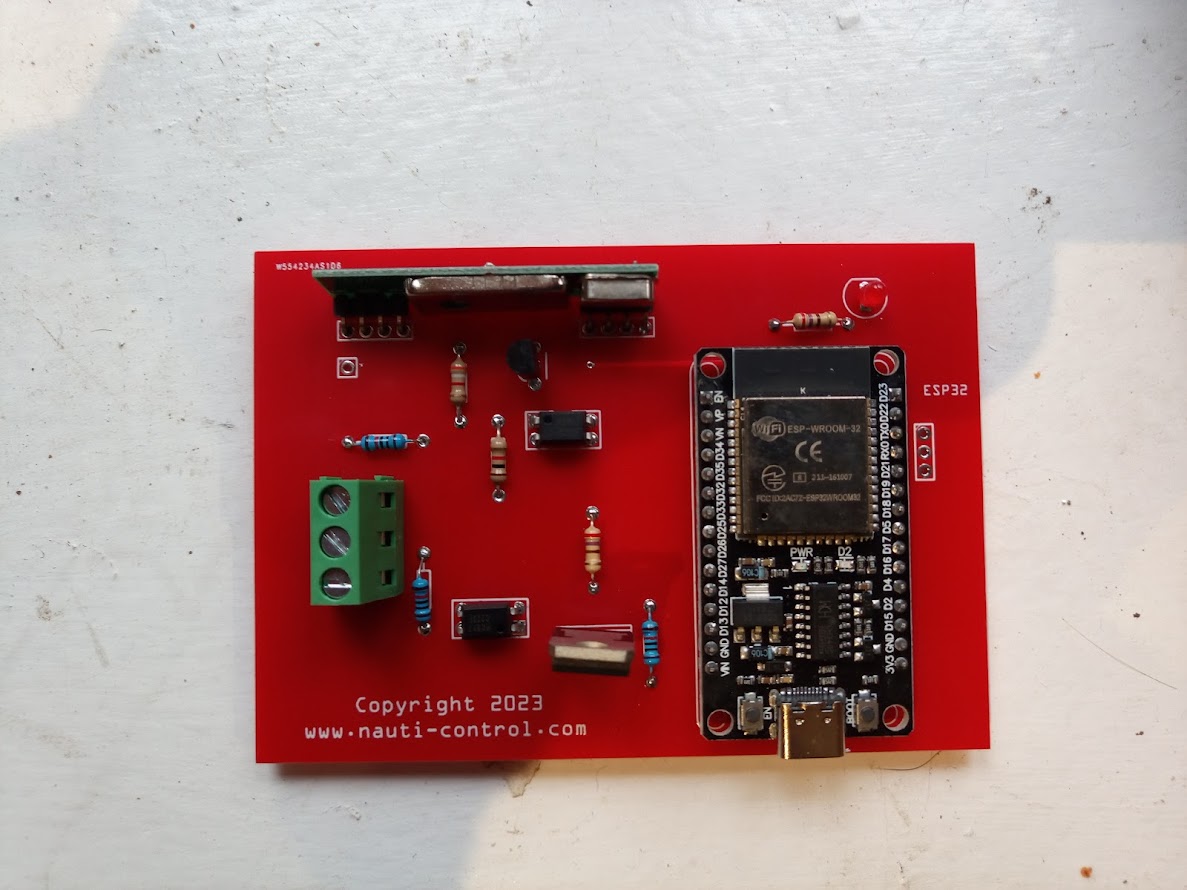

I've worked this last year on a project for my boat to allow me to control my Autohelm / Raymarine ST1000+ auto pilot remotely . It uses a 433mhz remote and the buttons can be mapped to various functions including the normal +/- 1 | 10 etc . There is a web interface for controlling it on a phone and i'm working on an app for my android wear watch that i'll share as open source as well.
Stuff i'm working on that'll work on the hardware include Seatalk to NMEA0183 duplex tcpip wireless multiplexer to allow open CPN to send and receive data . Also be able to feed your seatalk instruments from Signal K as repeaters if you have some kicking about like I do!
Link to github where you can get the circuit design , 3d printed case and code as well as some demo video links.
GitHub - nauti-control/STWirelessRemote: Open Source Wireless remote for Raymarine ST1000/ST2000 autopilots as well as ST60 speed timer.

Deploying the drouge would be a step beyond my abilities but if you had trailing lines stopping/slowing the boat would be something ! If you have all raymarine gear the mob panic button will send alert to chart plotters / gps and other instruments . Once you hook into things like autopilot and instruments theres a lot of cool stuff you can do !
THey arent that hard to build , though I've a few pre-built ones on there for sale that are ready to install.
