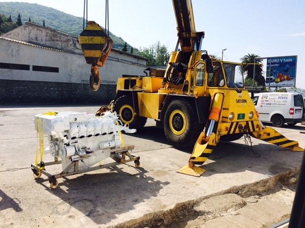

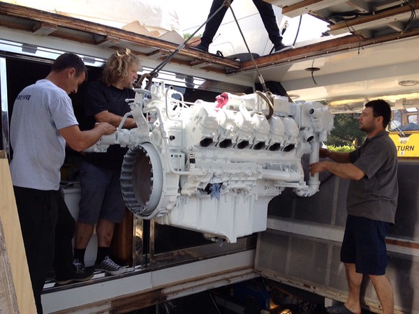

newly looking engine is now in the boat,
and the Guy's will continue the installation and in boat tests the coming day's.
will post pics from the lift in soon

as can be seen on the pics, they took off the exhaust manifolds, en the turbo's, for making the engine smaller:
more pics on Elly's Phone, will come later
