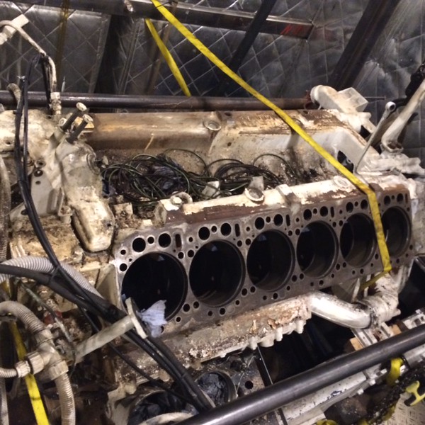

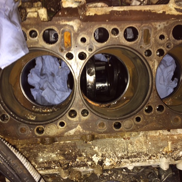

There were 6 cylinders filled with water,
all 6 on the same side, the side with the broken exhaust manifold
so far there was no indication of overheating on the liners nor the pistons
update

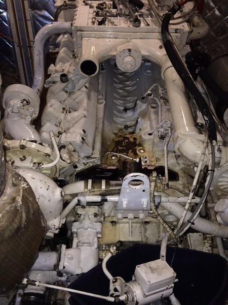

the engine is almost completely disassembled, and parts are checked and veryfied
apart from the exhaust manifold, no other damage from the overheating was found,
the crancshaft is completely within tollerance
got the parts list and quote for the repair, (just a bit more than half from the first engine)
major parts after the overheating are 2 exhaust manifolds (only one is broken, but both were overheated)
and oil coolers,
new valves and new valve guides
then for the rebuild, to be replaced anyway:
vibration damper
new pistons, new liners,
and many bearings and gaskets

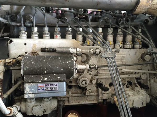

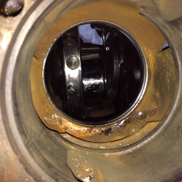

After arrival in Rovinj, I noticed some engine oil pooring over the SB engine, and quite a few liters in the bilge,
Oil came from under the fuel injection pump. (which is on top of the engine)
Oil level in the crank was just about minimum level
Calling with Ilko, he pointed immediately at a small O ring between the pump and the engine block, (for the oil circuit to the injectionpump)
No big deal to repair, but a lot of work to get acces taking off the injector pipes, and intercooler tubes, etc…
Ilko organized a few day’s later a local collegue in Zadar to look at it.

In Zadar “Romeo” came along, cleaned everything to find out what we already new,
The leak is between the injection pump and the engine block,
He was not brave enough to start the job, taking off the pump to fit a new O- ring (not enough time, etc..)

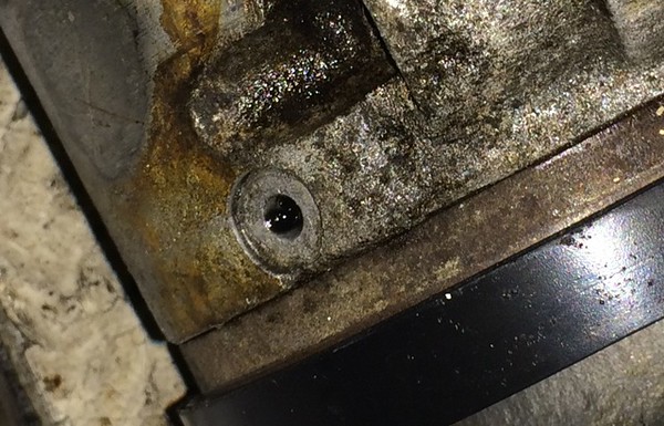

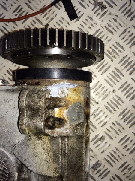

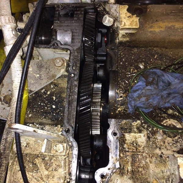

In Trogir, Mate and his collegue came as promised, spend a few hours to dismantle, (he is a MAN guy / friend from Ilko)
They found a perforated O ring,

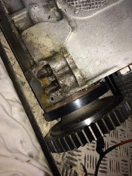

But then, they noticed that the O-ring seating on the pump was slightly damaged / corroded
They thought that a real repair would take a few day’s, but I told them that this was very anoying for the new guests onboard
So they proposed a temporary repair with some liquid metal, or tried with different kinds of epoxy,
but none of it worked out satisfactory for them.
Here you see some epoxy on the seating, but that didn’t stick on the de-greased metal surface
Here is the engine without the injection pump, and open gearbox
At 16h they took the pump and left to a metal worker in Sibenik,
Around 20h they came back with a repaired seating, the metalworker had made a circular groove with a router, and placed a small metal ring inside,
Seemed to me a real professional job, sorry no pic unfortunately,
They told me the hardest part was the fixing of the pump in the router, as the pump has no single flat surface….and is completely unsymmetric.
Around 23h they had reassembled the engine, and running again, all very good and clean,
