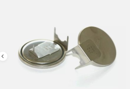

I have a mono RC435 plotter which still works fine, must be 25 years old. The only problem is the back up battery is dud so it always restarts in the USA and does not hold any settings. Not a huge problem for a back up set.
The battery is secured to the board in fine style so not easy to replace.
suspect it might be generic battery.anybody who knows what they are doing with a solder sucker and soldering iron can probably sort that.

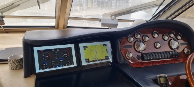

I don't have an indoor boat at all, that picture is of the lower helm, to show the 2 £120 tablets.
On the flybridge i have a pair of Garmin GPSMAP MFDs, both totally touchscreen. They both work perfectly OK when it's raining, and no problem in a F5 or even F6, we try and avoid anything stronger, as did the GPSMAP on my previous sailboat. I suspect they won't work very well if i was wearing gloves, but i don't wear gloves.
If you prefer knobs, that's great, buy something with knobs.
