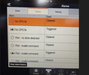

In summary when I turn the system on all is good and no issues but when I try to use the autopllot I get the following errors:
Pilot - no drive detected
Pilot - invalid command

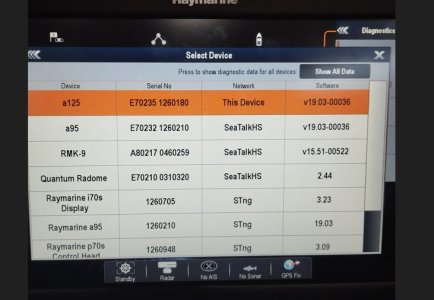

I have tried the diagnostics under maintenance and the ACU400 does not seem to appear in the ALL DATA list, but THINK it used to before though not sure.

Thanks but am not seeing the ACU400 showing on the SEATKALKNg network when I run the diagnostics page. So for some reason it no longer shows up.
