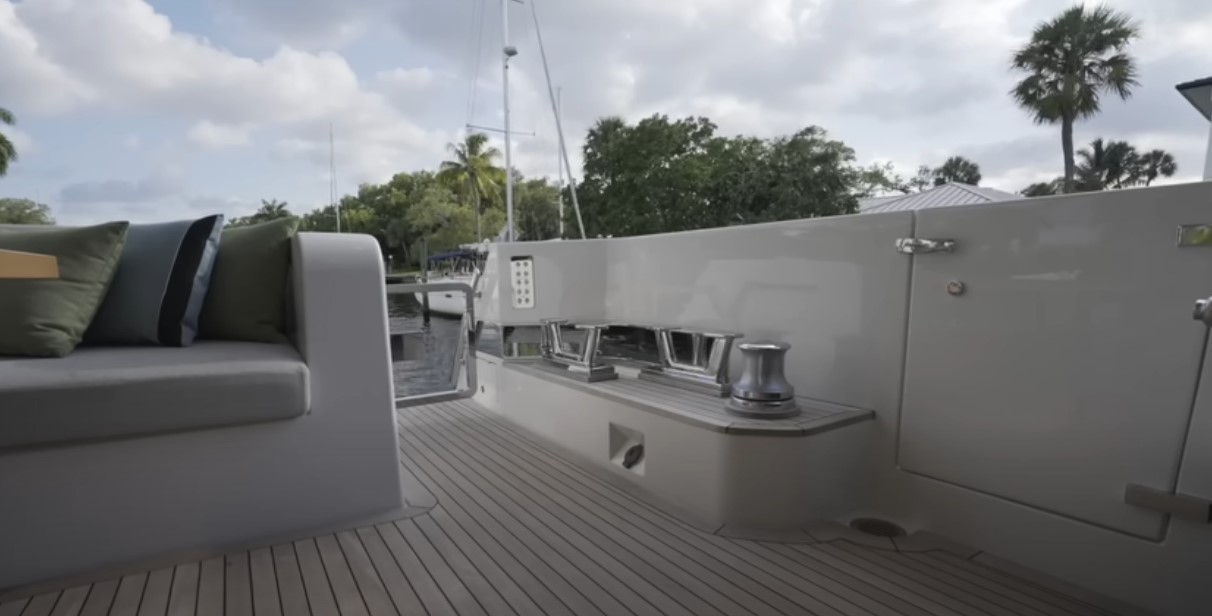

Baby brother (or sister) to yours. Are you having the teak over the curve by the stern winch kit. I’m not completely sure on that. Love the capping rails though!

I'm also not a fan of caulked teak surfaces other than for decks and staircases. I would never have it on a table top, for example, and I deleted it for the semi circle under the flybridge windscreen on my last squadron 78. I have no choice but to have teak on the stern winch surfaces on this SL96A but they are more straightforward than on the SD 90, with no curves - picture below. This is standard spec. I'm ok with teak here, though I don't love the little teak pads under the cleats -I don't see any engineering benefit.

Any idea why they sit the cleats on the teak pads. Looks like all the hardware is sitting on those pads. Must be some reason?
Perhaps to align the ropes with the fairleads and/or the winches.
I wonder if it is just aesthetics?
That said, mounting kit on teak pads is quite common to my mind so, whilst noting that JFM doesn’t see any engineering benefit, I wonder if they also serve some purpose in providing a bed to absorb some pressure from tightening securing bolts?
You don’t have to trim / place / set the teak around the three items if they were bolted on first .
Placing them on pads over the top of the existing freshly laid teak ensures a tight , neat joint .As Greg says the wood pad will absorb and pressure differences from the flat ness or un flat ness of the two fitting surfaces .Particularly the teak top of the plinth .There’s an extra 10 mm of kinda compressible base circumference structurally every bit helps I guess .
Makes perfect sense to me to do it this way .
I’m a little confused..is this discussion about the teak decking underneath all that deck hardware...or...the teak plinth under the winch?
